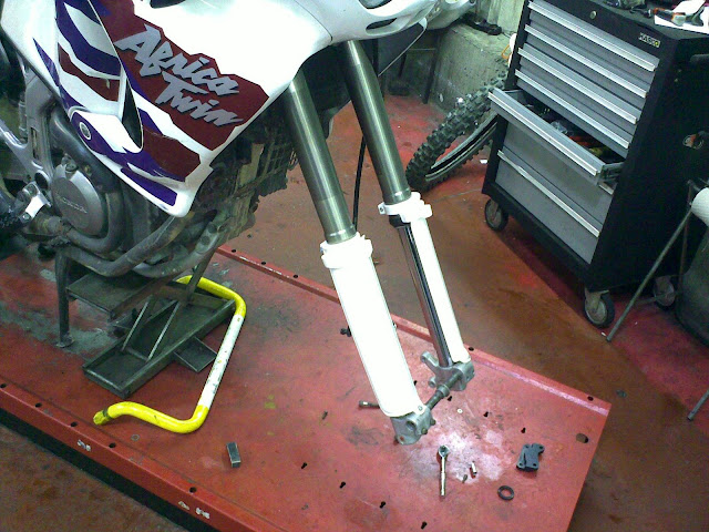

    Hi guys.

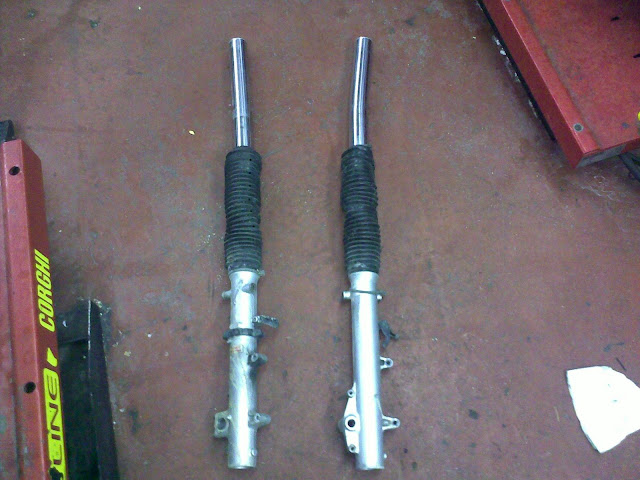

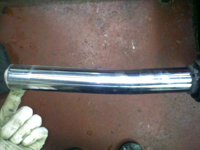

    About two monthes ago i rode into a road barrier.

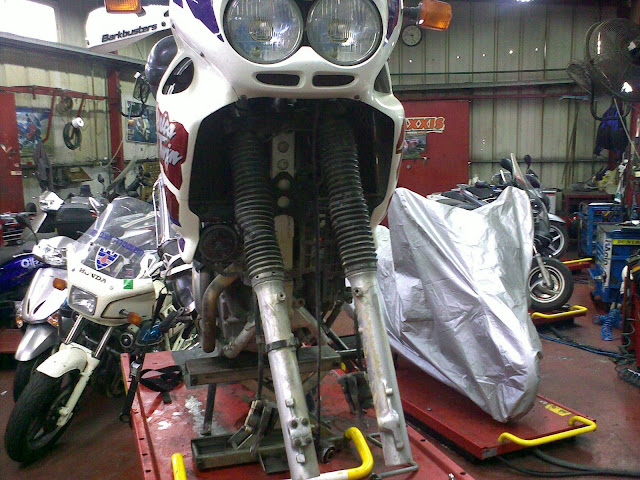

    I never liked the OEM forks anyhow so i had the opportunity to upgrade my AT.

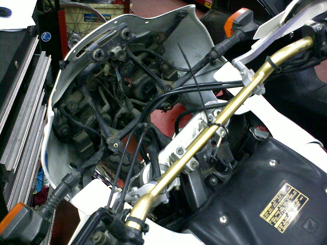

    some pics befor the work began.

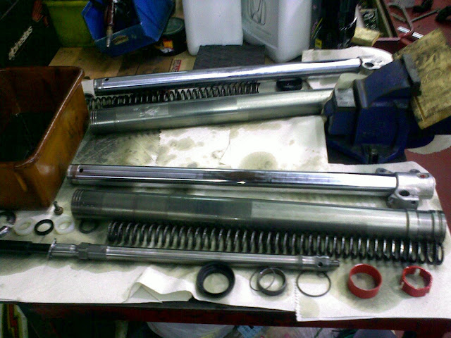

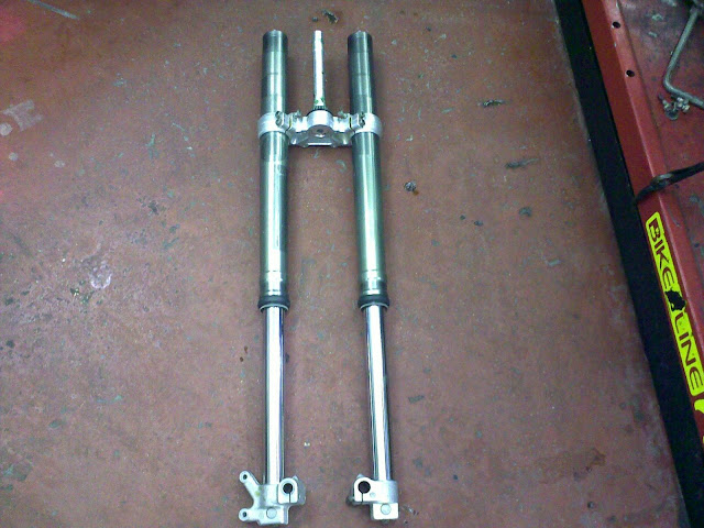

    so i got myself a KTM 620 front.overhauled them.

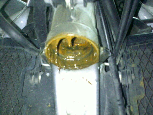

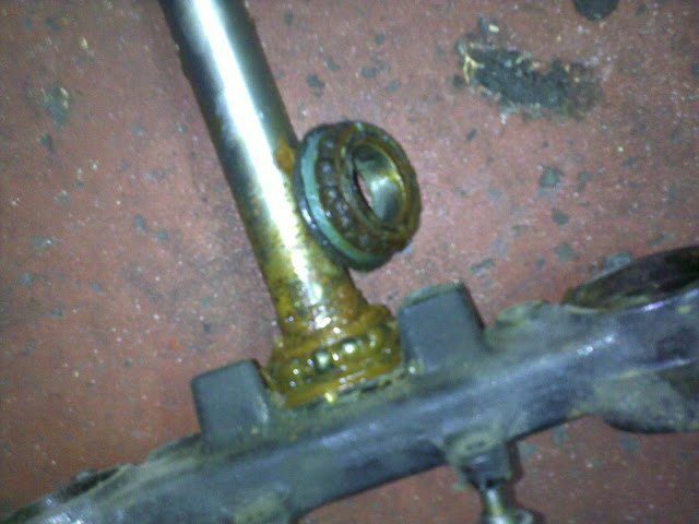

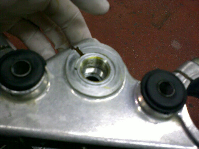

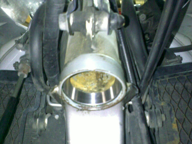

    seems like i had water in my steering...bhhaa....

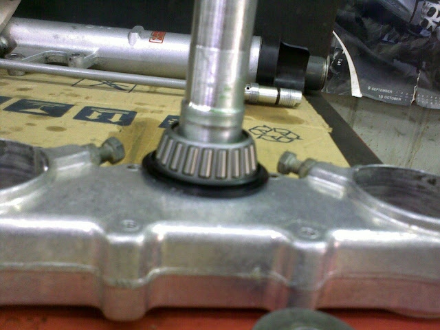

    new XR600/650 bearing

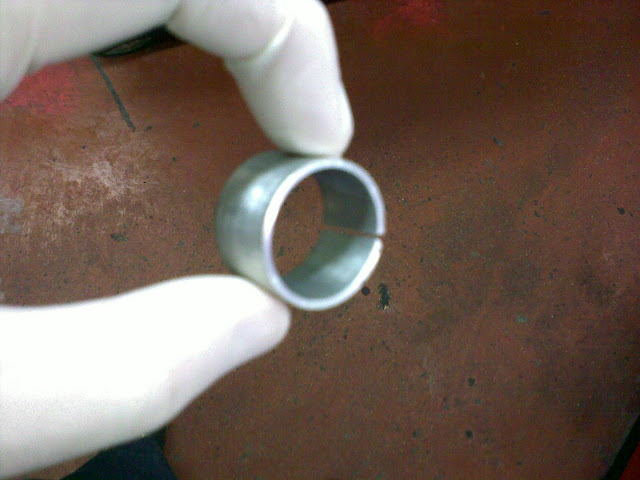

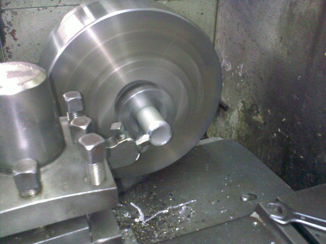

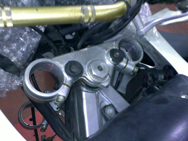

    the bottom clap axle is too wide to have the KTM bearing to fit the AT.
    so i machine the axle and make it thiner.
    after doing so, i had a small gap between the axle and the top clamp.

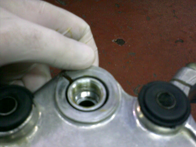

    so i machined a spacer to fill this gap.
    top clamp is on

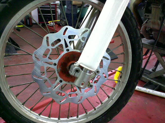

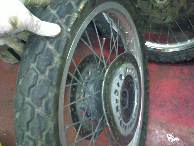

    new 320 mm disc
    new Givi crashbars
    i'm wating to the KTM caliper and a Trailtech dashboard.
    thats it for now.

    Re: RD07 front fork upgrade
    Looking good.
    Did you fit stronger springs.?
    Quote Originally Posted by AIRWOLF View Post
    Looking good.
    Thanks!
    Not yet.
    I need to check sag, than i'll do what ever is needed.
