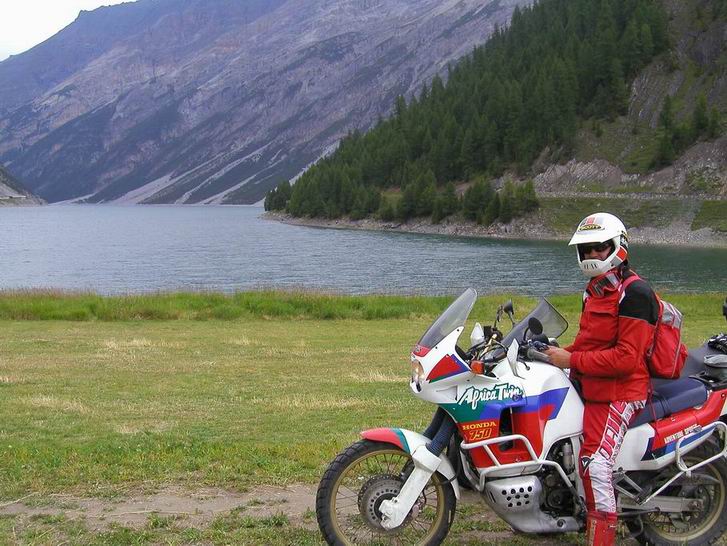

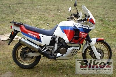

    As to my very limited knowledge, the RD04 only came in 7 different color options 1990-1992:
    Option 1: Red/Blue/White
    Option 2: Red/Blue/White (With the Greenish trim on fairing, and front fender, and the letters Honda 750 and Adventure Sports in yellow)
    Option 3: Blue/Red/White (Red and Light Blue have switched places)
