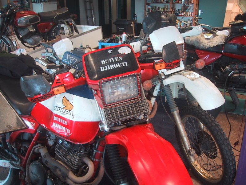

    But yeah, cooling helps. A friend of mine has a 2CV cooler with thermostat on a XL600 that spent 27.000 km going 'round the sahara. Bike hardly ever gets above 90 degrees oil temperature even on the motorway, which is pretty much perfect.
    (There it is, underneath the headlight.)
    The 2CV cooler is quite big, so you'll need a thermostat of some kind (lockhart in the states makes a nice one, if you can find it) or you'll never get the bike warmed up...
    You can buy coolers ready made for the NX (Egu Motoren in Germany do one), they are smaller, about half the size of a 2CV cooler, and without a thermostat. Warming up takes a bit longer, and you might have to cover the cooler with a bit of cardboard in the winter...
