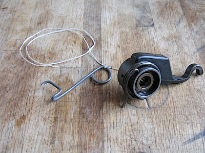

    the chain tensioner is composed of 3 parts:
    -the spring
    -the part which tensions the chain
    -the axle
    the tensioner complete with the spring but without the axle is aprox 80 euro. should i buy the axle too? (i couldn't see any traces of wear on mine)
  10. #19
    pasajerobg is offline pasajerobg
    Jun 2007
    Varna - Bulgaria
    7
    Re: Noisy engine ... with Video!
    You need to replace only tensioner, the spring and axel is ok, you can see on the pic here what you need to buy: http://lh3.ggpht.com/EL23971/R3mCgxK...0/IMG_0642.JPG
    Cheers
