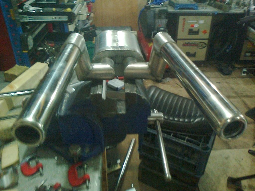

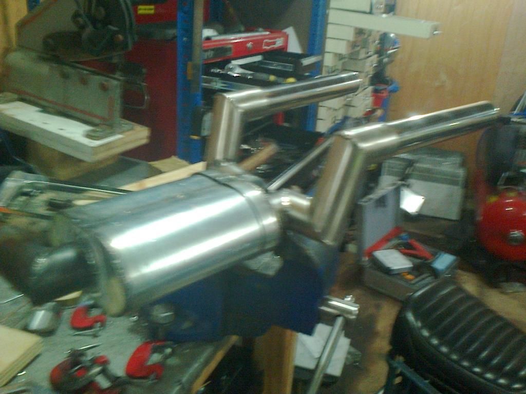

been busy making up another exhaust for the constantly evolving scrambler ,
not quite finished yet but the majority of the fabrication is done , quite pleased with this one ,
made up a muffler box which has one inlet which splits into two perforated tubes and twin exits linking to two vw beetle baffles ,
has a bit of the starship enterprise about it :)

yes I know the bike is filthy planning a full strip down and spruce up over the winter

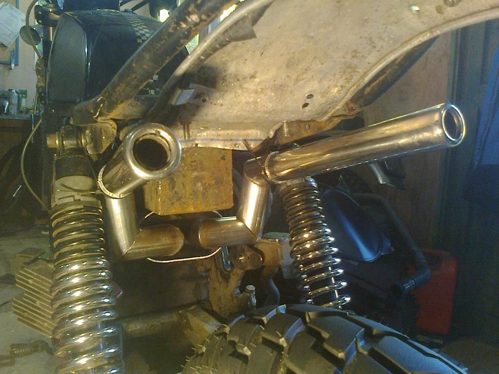

I need some fresh ideas for my bike build , could you please send me some of whatever it is you have been smoking :D:D:D
Whats with those rear shocks?
Whats with the two different springs on each shocker?

haven't smoked anything for 20 years , I rely on the force for my inspiration these days :)
dual rate shocks , basically twin shocks are quite simple devices which don't have clever rising rate linkages like monoshocks ,
so these shocks have a small soft spring to iron out the small bumps and a heavier weight spring to take care of the bigger hits

you're dead right it was a right pain , imagine you're no stranger to a bit of perplexing jigging yourself so you'd understand just what a game it can be ,
the chunki chop its got to happen sooner or later , and a proper work of art i'm sure it would be , go for it ,
scousedude answere to your question just fired it up and it sounded great , not too loud but just how a thumper should sound ,
seems to flow just fine , revved up well , couldn't ride it how it is as got lots of bits to relocate but quite optimistic that it will go well :)

couple of pics of the new exhaust fitted to the bike
http://
http://
think this is the best set up so far as far as looks , performance and sound are concerned,
now its time to tidy the shed before starting the next project :)

already working on a mk2 version of this exhaust , as I can see a few areas where it can be improved

yea that sort of thing , was also hoping to reach warp speed 11 when I open it up exiting asteroid belts but am only managing 10 ,
think some larger diameter baffle tubes and a less convoluted design will help , could also be a bit noisier without attracting too much attention ,
