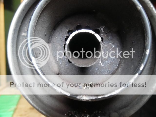

Took the plunge & debaffled my SLR today
What a difference in sound, now it sounds like a big single should(poor man's KTM I guess:))
Will tackle the carb removal for rejetting next
Pictures tell the story, not the prettiest but who cares the sound is amazing!!

That doesn't look so bad, I use a hole saw now so it looks really clean.
Wait till you get that 175 main jet in, you'll be amazed at the difference!
As discussed on this forum you should also remove the airbox snorkel and set the pilot screw at 3 or 3.5 turns out.
I've done several of these now and three of them started slipping the clutch after the baffles were pulled, the clutches were fine before so I take that as proof of the increased torque.

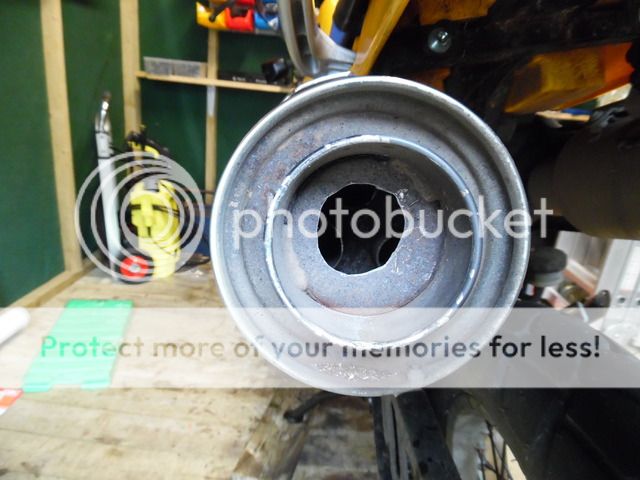

Hi Bob
I couldnt manage to use a holesaw as I couldnt get the depth with the pipe in the way & I made no headway with a dremel trying to make the pipe shorter to give me access so I went with the multihole option & it got the desired effect anyway:)
I have a 170 jet ready to go in because I thought that was the correct one for the SLR & that 175 was for the Vigor just reading past threads on the subject
Anyway I'll try the 170 first & see how it goes. The pilot screw is already out sufficiently as I unscrewed it by 1 turn & tickover seems fine.

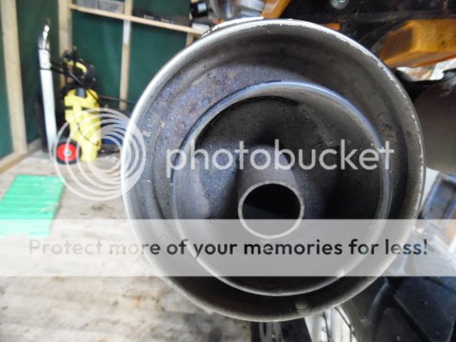

695 Posts
I just go at it with a 38mm hole saw, the output tube helps to centre the cutting face. Once it starts cutting it will stay on course.
I've never had to change the chain when fitting a 15T front.
The mods will give more torque across the range and greatly improve the low down smoothness and pull, but these are an oversquare engine so there is a limit on how hard you can work it at very low RPM. You should find the mods give you a boost on the top end at WOT too.
Some of the SLR and FXs I've done have started slipping the clutch immediately after the mods, where there was no slip previously, I take that as proof of increase in torque.

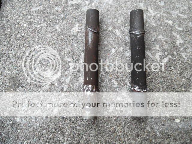

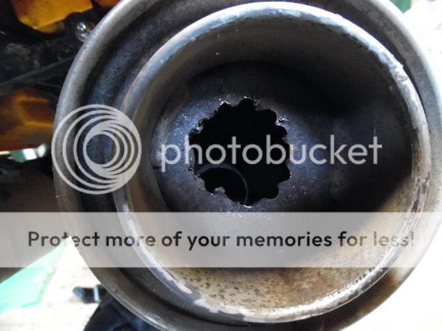

Hi Ray
I encountered the same problem with a holesaw & couyldn't overcome it regarding getting it centered as my saw didn't have enough depth to overcome the length of the little tailpipe & I couldnt manage to cut the little tailpipe using a dremel so I just drilled a series small holes all around the tailpipe.
I found it a bit of a struggle getting the baffles to loosen at the inner end but after much jiggling I managed to remove them. I cleaned up the ragged edges with a tapered stone in a standard electric drill.
Didn't turn out too bad!!
The exhaust note will be noticeably louder with the baffles removed so don't be surprised but I'm a fan of loud pipes anyway:D
Standard chain should be OK
