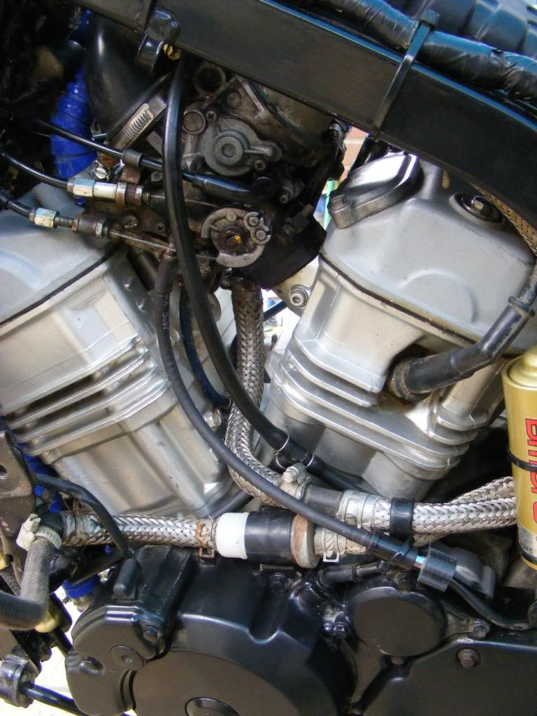

Been runing the bike with no easy way of adjusting idle, as it only ever had a screw when i bought it (not very easy to adjust with my big mitts). As the bike was nekkid, decided to bodge something that was easy to get to and it works - and it was cheap:eek:ccasion8:.
Bought one of these first:
12" FLEXIBLE EXTENSION for SCREW DRIVER / DRILL (tool)
12" FLEXIBLE EXTENSION for SCREW DRIVER / DRILL (tool) on eBay (end time 27-Mar-10 20:10:14 GMT)
soon took that apart once it came thru the post :angel10: made a knurled knob out of some delrin bar (bloody ace stuff :thumbleft:)
bit of araldite palstic tube and some heatshrink and heres the result (its the lower cable with the knurled knob on the end):
