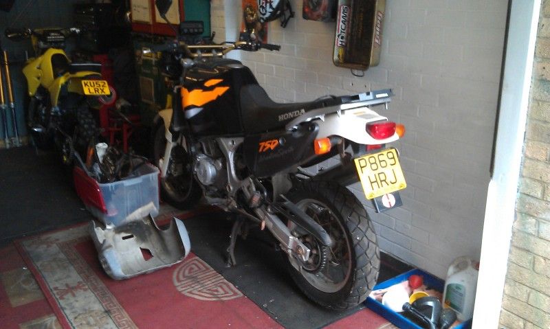

Hi People , Just got my mits on a P reg bike with 32k on it. It's been off the road since 2006 when it was dropped: the damage was to the tank, fairings and screen. Now I've already been onto Paul from SFX wheels he is going to sort the hubs and rims out in black and lace them up with HD stainless spokes :).
Next is, while they're away the rear end will come out and get a good clean throughout, along with a longer shock hoof. This should raise the rear a bit. Need to source or find a pic of some fork extentions thus raising the front as well.
'Im going to remove the exhaust system, blast that and paint it in heat proof paint. Also, I might wrap it as well. I'm after putting another can on to make it sound as it should. Where do I find the link pipe from the original system to an after market can?? Im going to put some oil down the bores later and let it sit there for a few days before I get a battery then turn it over without the plugs and see how we go.
Ive been onto a graphics company: they have got some for the twin. Hopefully mine is there, very reasonable as well.
Really it needs a very good clean with the old Gunk and tooth brush and the odd splattering of powder coated parts and some goodies from Overlander.com. Will update as I do bits and bobs.
well here goes :-D
