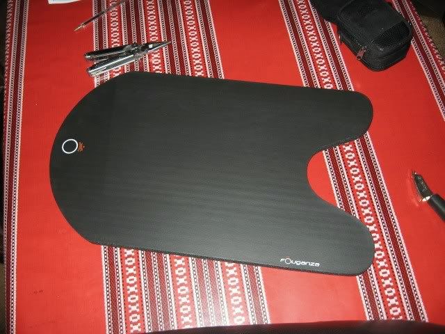

this one for 9€
its a medium density foam sandwich, about 25mm thick.

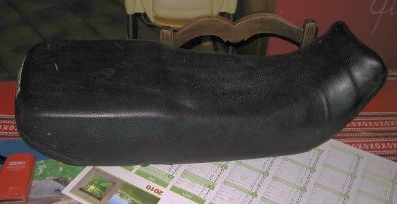

with the offending article

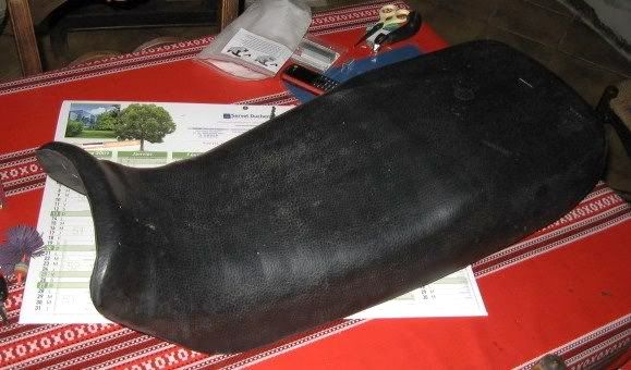

I turned the seat over & pulled the staples from the underside to remove the vinyl cover completely.

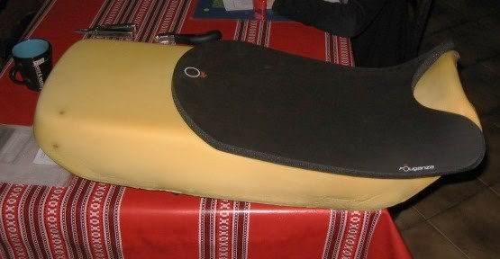

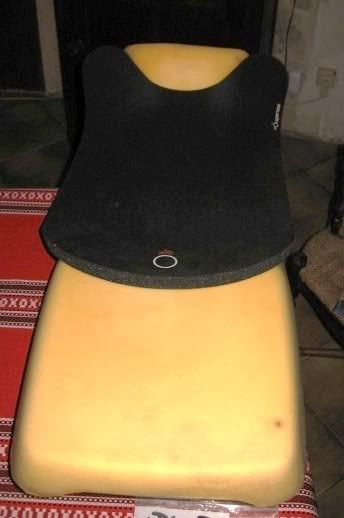

positioned the foam pad
I hope I've got it where I want it, it's a bit difficult to work out exactly where I sit on the seat when it's not on the bike & I wanted to try & keep the seat's original line & cover so I couldn't mess with it too much as the tralp seat has a step up about halfway back, so I had to fit the pad sufficiently forward of thet so's not to have to cut into the rise, but far enough aft for my fat arse to sit on. which is kinda the whole point of the excercise...

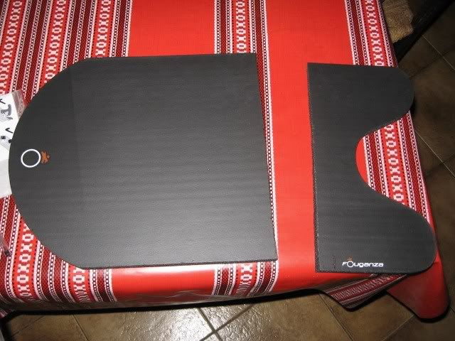

I decided that trying to cut the forward curves into the existing seat foam was going to be too complicated, & so cut the saddle pad

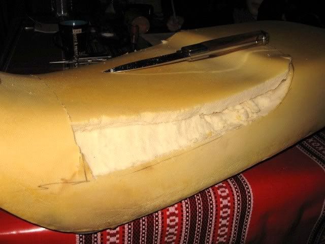

repositioned it & marked out the seat for cutting. Then attacked it with a sharp knife.
I you've never cut this sort of foam, you need a REALLY SHARP knife, preferrably one with a curved blade, otherwise the point simply pulls holes in the surface, & you cut along a line, 2 or 3 passes with the blade, with very little pressure. Once the surface is cut, you pull the cut open with one hand & slice the bottom of the cut with the knife untill you've reached the required depth. You end up with little bits of foam bluddy EVERYWHERE, or at least I did, but I didn't take any pictures of it cos it wasn't funny... despite what my daughters might tell you...
I cut downwards along the edge of the seat first, & then in from the side, allowing me to remove the "corner" peices as in the pic above.
this allowed me to cut horizontally through the seat at about the right depth to fit the new foam pad & remove the foam in one peice leaving a "fairly" even surface underneath. I then pinched out the foam along the edges to give a rounder profile to allow the new foam piece to bend into the shape easier.

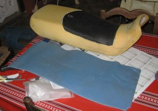

I left it 48 hours for the glue to cure & took the strap off. Despite my best efforts, there were some fairly big gaps between the forward & aft edges of the new foam & the original seat foam. The seat cover being fairly thin, I thought it best to find something to help even out the gaps & lumps a bit.

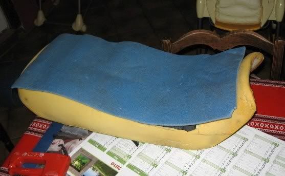

GOT IT! an old sleeping mat that's no longer used, to cover the whole top of the seat (0€)
I didn't glue this mat on (cos I had no glue left) & reckoned that the seat cover will hold it sufficiently.
Put the seat cover over the top, taking care that the blue mat didn't wrinkle or pull out of place. With the extra thickness (blue sleeping mat) I had to pull the seat cover fairly hard into place & staple it back onto the seat base, again taking care to pull it evenly so's not to make wrinkles.
