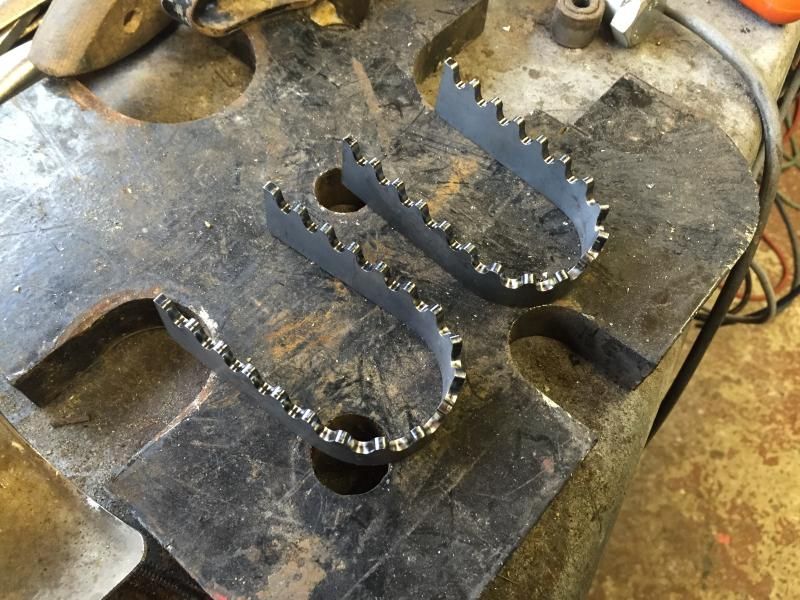

I've got wide footrests on the xr and it does make a difference on your feet when standing up for long periods i measured the width of those for an idea of how wide to bend these to i used a socket that was 40mm outside diameter and clamped it in the vice to bend them
Had to space the socket off in the vice to finish the bend
after the bending i ended up with these

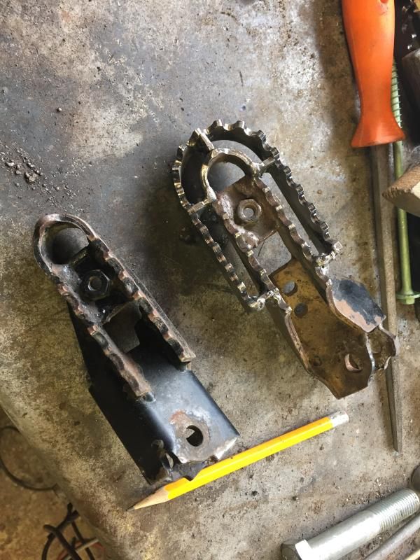

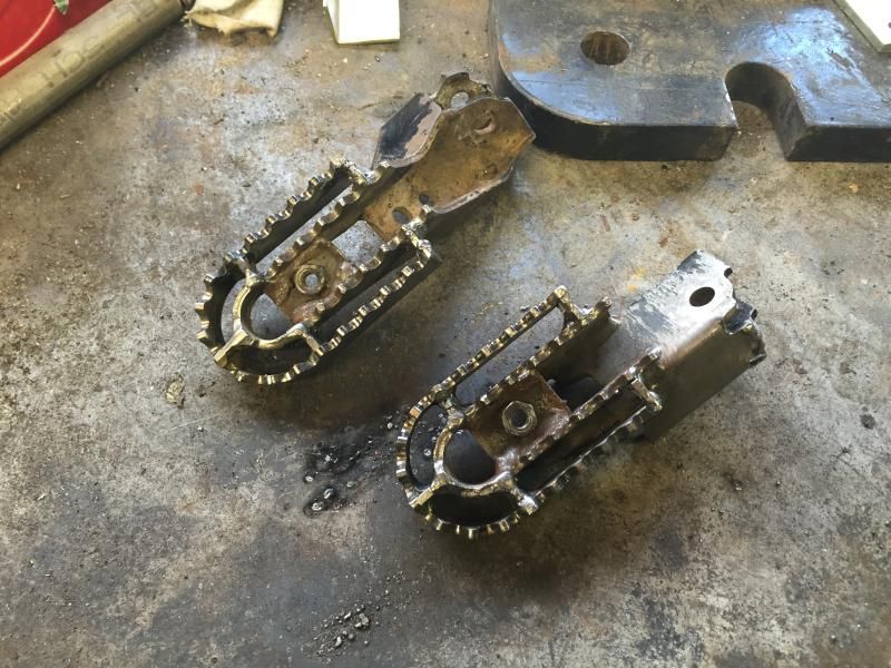

I cut and welded on some lugs to the existing footrests to take the wider bits
Then welded on the extensions
Old and new together
and the two done

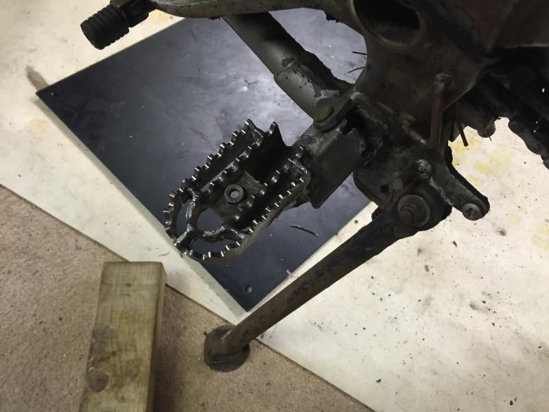

and fitted to the the bike for a look
I've sand blasted them and their in the paint shop drying (my shed :D ) as i type I'll put another photo of the finished job up when done quite pleased with them and only 3 hours work on what would have been a boring day :D

Thanks for the replies :thumbup: I've been on a few test ride's with the footrests fitted they dont feel that much different apart from them making my foot too close to the gear lever and having a few clumsy gear changes until i got used to them. I think the bigest difference is they look far better than the orriginal ones.
If i done the job again i probably would keep the front of the footrest where it is and widen them all towards the rear all the paint wear is on the front of the pegs none of the paint has worn off the rear at all which sugests i dont flat foot the pegs when riding so im not taking advantage of the greater surface area still they look good :D
